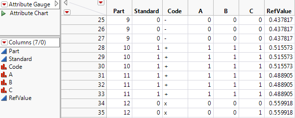

Responses in the different columns can be character (pass or fail) or numeric (0 or 1). In Figure 9.2, rater responses are numeric (0 for pass, 1 for fail). All response columns must have the same data type.
Any other variables of interest that you might want to use as X, Grouping variables should appear stacked in one column each (see the Part column in Figure 9.2). You can also define a Standard column, which produces reports that compare raters with the standard. The Standard column and response columns must have the same data type.
Figure 9.2 Attribute Gauge Data
