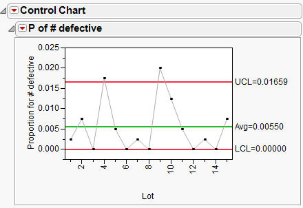

Figure 3.21 p-chart
The p-chart shows the proportion of defects. Note that although the points on the chart look the same as the np-chart in Figure 3.22, the y axis, Avg and limits are all different since they are now based on proportions.
