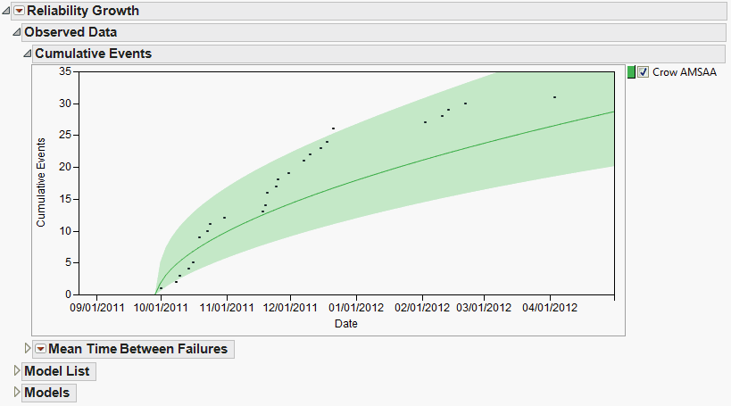

From the red triangle menu at Reliability Growth, select Fit Model > Crow AMSAA.
The Cumulative Events plot in the Observed Data report updates to show the model (Figure 9.25). The model does not seem to fit the data very well.
Figure 9.25 Cumulative Events Plot with Crow AMSAA Model

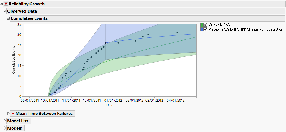

From the red triangle menu at Reliability Growth, select Fit Model > Piecewise Weibull NHPP Change Point Detection.
The Cumulative Events plot in the Observed Data report updates to show the piecewise model fit using change-point detection. Both models are shown in Figure 9.26. Though the data are rather sparse, the piecewise model seems to provide a better fit to the data.
Figure 9.26 Cumulative Events Plot with Two Models
