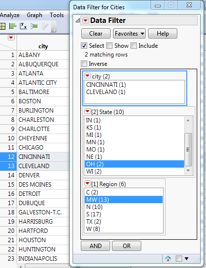

The following example illustrates how the Conditional option helps show the subcategories clearly, without the extra categories that do not belong.
Select Help > Sample Data Library and open Cities.jmp.
Select Rows > Data Filter.
In the Data Filter window, select city, State, and Region, and then click Add.
Select Conditional from the Data Filter red triangle menu.
5.
Select MW in the Region list.
6.
Select OH from the State list.
Figure 8.11 Using the Conditional Option
The bracketed number in front of the column name indicates the order in which the column values were selected. In Figure 8.11, Region was selected first, so it has a [1] in front of the column name. State was selected second, so it has a [2] in front of the column name.

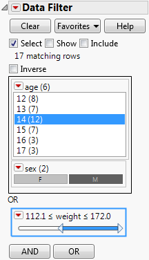

Click OR and add the weight column.
7.
Move the left weight slider to approximately 112.
14-year-old males or students who weigh greater than 112 are selected.
Figure 8.12 Data Filter with OR Condition

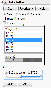

Select Grouped by AND from the Data Filter red triangle menu.
14-year-olds or males and students who weigh greater than 112 are selected.
Figure 8.13 Data Filter with Grouped by AND Condition
