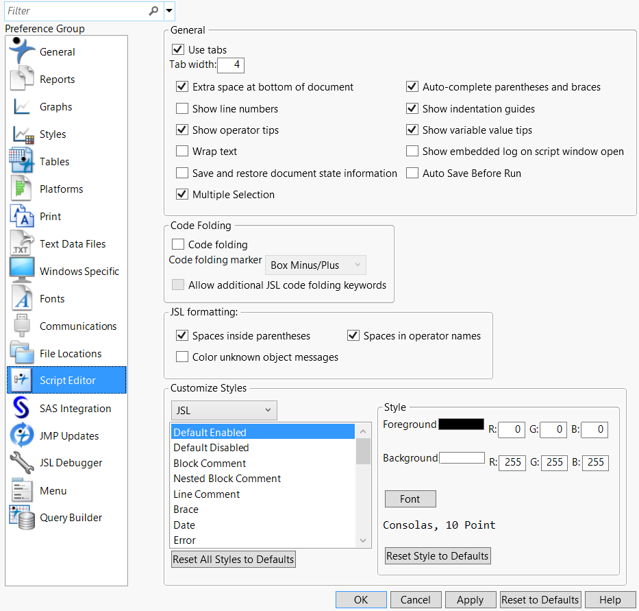

Figure 12.14 Script Editor Preferences
Select this option to use code folding markers in the script editor, which mark the opening and closing of user defined functions and Expr() blocks. You can expand and collapse these marked blocks of code. This option is off by default.
You can also choose the appearance of the marker using the JSL code folding marker menu. See Add Code Folding Markers in the Scripting Guide for details.
Select this option to enable using additional keywords for folding markers in the script editor. See Add More Folding Keywords in the Scripting Guide for details.
Select this option to cause the script editor to add spaces between words within operator names. For example, turning on this option results in New Window instead of NewWindow. This option is selected by default.
