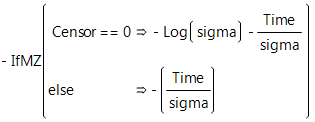

In the exponential loss function shown here, sigma represents the mean of the exponential distribution and Time is the age at failure.

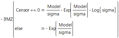

The formula shown below is the lognormal loss function where Normal Distribution(model/sigma) is the standard normal distribution function. The hazard function has value 0 at t = 0, increases to a maximum, and then decreases. The hazard function approaches zero as t becomes large.

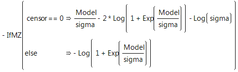

If Y is distributed as the logistic distribution, Exp(Y) is distributed as the loglogistic distribution.
