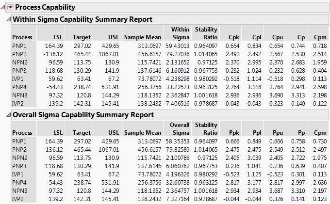

The Summary Report options show or hide a table that contains the following statistics for each variable: LSL, Target, USL, Sample Mean, various Sigma estimates, Stability Ratio, Cpk, Cpl, Cpu, Cp, Cpm, and Nonconformance statistics. These statistics are calculated using the sigma estimate specified in the report title. Figure 10.19 shows a subset of columns for both summary reports as described in Example of the Process Capability Platform with Normal Variables. The following optional columns are available for this report:
