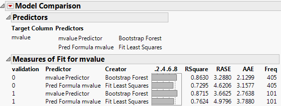

Figure 9.6 shows an example of the initial Model Comparison report for a continuous response.
Figure 9.6 Initial Model Comparison Report
