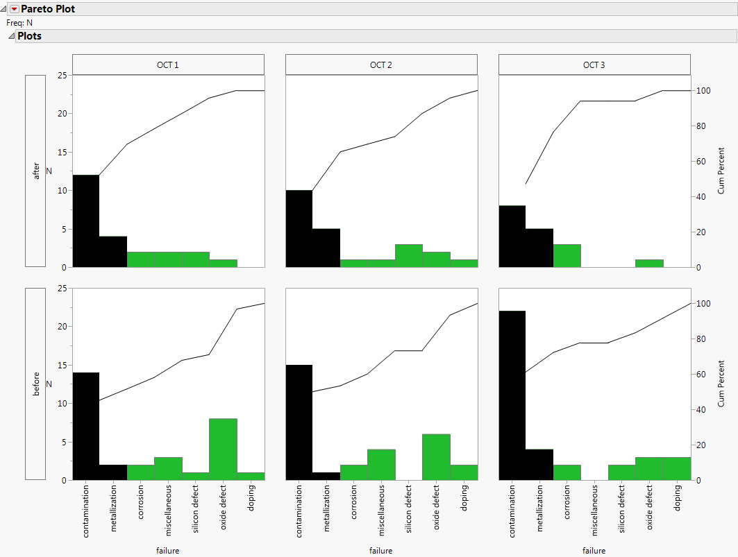

Figure 11.16 displays the Pareto plot with a two-way layout of plots that show each level of both X variables. The upper left cell is called the key cell. Its bars are arranged in descending order. The bars in the other cells are in the same order as the key cell.
7.
Click Contamination and Metallization in the key cell and the bars for the corresponding categories highlight in all other cells.
Figure 11.16 Two-way Comparative Pareto Plot
The Pareto plot shown in Figure 11.16 illustrates highlighting the vital few. In each cell of the two-way comparative plot, the bars representing the two most frequently occurring problems are selected. Contamination and Metallization are the two vital categories in all cells. After furnace cleaning, Contamination is less of a problem.
