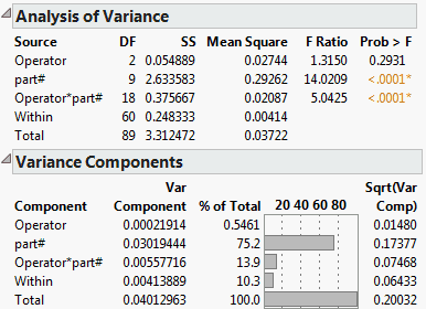

Figure 8.5 Example of the Variance Components Report
The Variance Components report shows the estimates themselves. See Statistical Details for Variance Components.

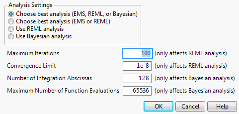

From the launch window, click Analysis Settings to choose the method for computing variance components.
Figure 8.6 Analysis Settings Window
Chooses the best analysis from EMS or REML, using the same logic as the Choose best analysis (EMS, REML, or Bayesian) option. However, this option never uses the Bayesian method, even for negative variance components. The bounded REML method is used and any negative variance component is forced to be 0.
