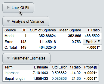

Open and Close Report Sections
Graphs and tables that were closed when the page was created remain closed in the web page until you open them. Open or close report sections by clicking or tapping the outline buttons in the report.
This example demonstrates how to open the Lack of Fit table. The Analysis of Variance and Parameter Estimates tables are already open.
Using the Outline Buttons
Figure 3: Using the Outline Buttons
