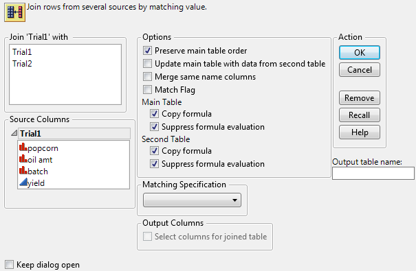

Select Tables > Join.
The Join Window
In the Join...with box, select the table to join with the active table.
From the Matching Specification area, select the option that specifies how to join the tables.
Click OK to create the joined data table.
To keep this window open after clicking OK, check the box beside Keep dialog open.

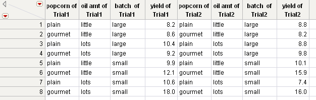

If the two tables have column names that are the same, the names of these columns in the new table appear as “column name of table name.” For example, suppose that you want to combine the eight rows from the Trial1.jmp and Trial2.jmp data tables shown in Original Tables and the Joined Table into a single table. You want to combine them so that the new table contains all of the columns from both tables.
Open the Trial1.jmp and Trial2.jmp sample data tables.
From the Trial1.jmp data table, select Tables > Join.
In the Join...with box, select Trial2.
From the Matching Specification menu, select By Row Number.

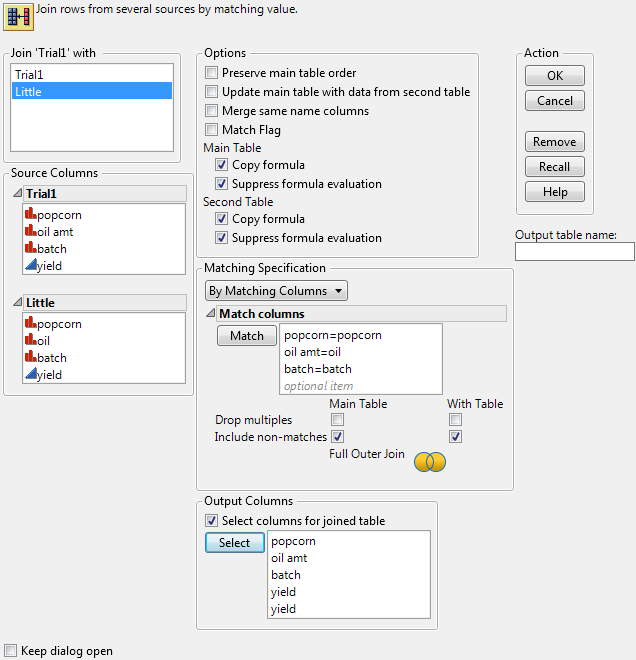

Open the Trial1.jmp and Little.jmp sample data tables.
From the Trial1.jmp table, select Tables > Join.
In the Join...with box, select Little.
You can see that three of the columns (popcorn, oil amt/oil, and batch) contain the same values in both tables. Identify these columns as matches. Also, because Sarah and Joe gave the oil and oil amt columns different names, you can tell JMP that oil amt and oil match.
Deselect Preserve main table order.
Select By Matching Columns in the Matching Specification area.
From the Trial1 list, select popcorn, oil amt, and batch.
From the Little list, select popcorn, oil, and batch.
Click Match.

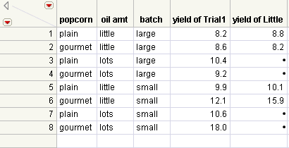

Looking at the two data tables, you can see that they have different numbers of rows. Trial1.jmp has values for eight experimental conditions, and Little.jmp has values for only four of those conditions. Sarah completed her experiment, but Joe only partially completed his experiment. You want the joined table to contain all of the rows in Trial1.jmp. even if that row in the Little.jmp table contains a missing value.
Select the Include non-matches boxes for both tables.
In the joined table, you only want one column for popcorn, one column for oil, and one column for batch. However, you want two columns for yield: one representing the yield from Trial1.jmp, and another representing the yield from Little.jmp.
10.
Select the box beside Select columns for joined table.
11.
From the Trial1 list, select all of the columns.
12.
Click Select.
13.
From the Little list, select yield.
14.
Click Select.
Completed Join Window
15.
Trial1.jmp and Little.jmp Joined
The joined table is sorted by the matching columns. Note that the yield column from the Little.jmp table (Yield of Little) has missing values indicating no matching values with the Trial1.jmp table.

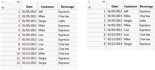

Open the Coffee Shop Purchases.jmp sample data table.
In the Join...with box, select Coffee Shop Purchases.
Click Match.
Select the Drop multiples boxes for both tables (the Main Table and the With Table).
Type Coffee Shop Purchases Final for the Output table name.
Original and Joined Coffee Shop Purchases Data Tables
