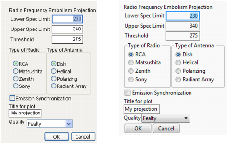

The following two code examples produce identical windows using the deprecated Dialog() method and the preferred New Window() with the Modal option. New Window provides more display options and better control over the content and functions of the window.

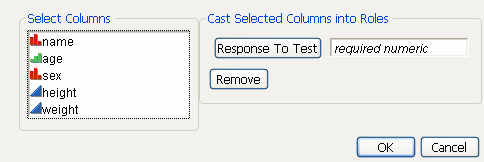

Column Dialog, a variant of the deprecated Dialog function, lets you prompt for column selections from the current data table or contextual data table, which must already be open.

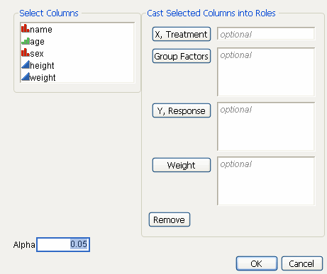

For each destination list, a Col List clause must be a direct argument of Column Dialog (not nested inside some other argument). An optional MaxCol(n) argument restricts the number of data columns that can be chosen to n. The resulting list contains the “name” list that is enclosed in parentheses. Lists are always returned, although they can sometimes be empty lists. You can include as many as twelve Col List clauses.
Other items permitted in the deprecated Dialog command are permitted in Column Dialog also, and have the same functionality. The OK, Cancel, and Remove buttons and the list of columns to choose from are both added automatically.
You can specify the minimum and maximum number of columns that are allowed in a column dialog box with the MinCol and MaxCol arguments. You can also specify the modeling type of the columns that are allowed to be selected (Ordinal, Nominal or Continuous). You can set the width of the list using Select List Width(pixels) argument. To set the width of the column list, use Width(pixels) inside the Col List() function.
In addition, use the Columns specification to pre-fill some column selections. For example:
