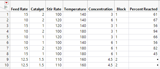

Figure 6.15 Design with Two Center Points Added
After data has been collected for the two center runs you can then test for curvature in your model.
