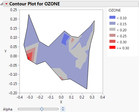

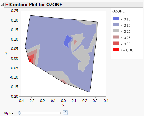

Figure 10.10 Contour Plot for OZONEĀ
8. Click and move the Alpha slider to the right.
Figure 10.11 Alpha Shapes FilterĀ
Using the Alpha slider filters out the larger Delaunay triangulation areas.
