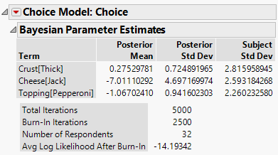

Figure 4.17 Bayesian Parameter Estimates Report
Term
The model term.
Posterior Mean
The parameter estimate for the term’s coefficient. For each iteration after the burn-in period, the mean of the subject-specific coefficient estimates is computed. The Posterior Mean is the average of these means.
Tip: Select the red triangle option Save Bayes Chain to see the individual estimates for each iteration.
Posterior Std Dev
The standard deviation of the means of the subject-specific estimates over the iterations after burn-in.
Subject Std Dev
The standard deviation of the subject-specific estimates.
Tip: Select the red triangle option Save Subject Estimates to see the individual estimates.
Total Iterations
The total number of iterations performed, including the burn-in period.
Burn-In Iterations
The number of burn-in iterations. This number is equal to half of the Number of Bayesian Iterations specified on the launch window.
Number of Respondents
The number of subjects.
Avg Log Likelihood After Burn-In
The average of the log-likelihood function, computed on values obtained after the burn-in period.
