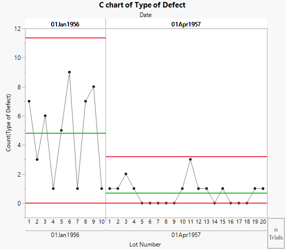

Figure 3.21 C chart of Type of Defect with Phases
You can now view the results on the two different days. Both appear to be within limits. To examine other defect type behavior, select another defect type under the Event Chooser > Type of Defect and view the results as the limits are updated.
