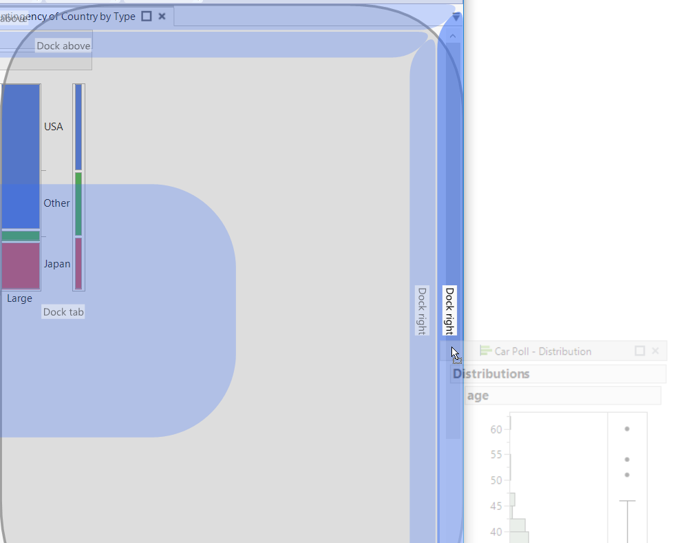

3. Drag the Distribution report tab to the right until the Dock right zone appears on the far right.
Figure 10.17 Dragging a Report
4. Drop the report into the Dock right zone.
The tab appears in a new pane.

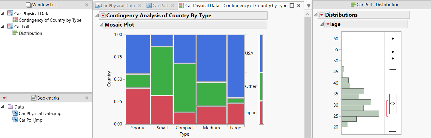

5. Drag the Contingency tab to the middle of the Distribution report.
6. When the Dock tab zone appears, drop the report.
Figure 10.19 Docked Report Tabs
