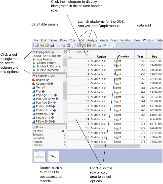

In JMP, data points are organized into rows and columns referred to as the data table. A data table has two parts: the data table panels on the left and the data grid on the right.
You can enter, view, edit, and manipulate data using data tables. In a data table, each variable is a column, and each observation is a row.
Figure 2.3 Data Table Features
