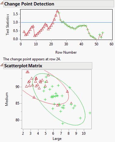

5. Click the red triangle next to Multivariate Control Chart and select Change Point Detection.
Figure 10.11 Change Point Detection for Gravel.jmp
Tip: You might need to drag the axes to see the density ellipses for the two groups, depending on your data.
In the Change Point Detection plot, values above 1.0 indicate a possible shift in the data. At least one shift is apparent; the change point occurs at observation 24 and the shift occurs immediately after observation 24. The 95% prediction regions for the two groups have approximately the same size, shape, and orientation, visually indicating that the sample covariance matrices are similar.
