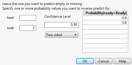

3. Delete the value for heat.
You want to find the predicted value of heat, so you leave the heat value empty.
4. Enter 2 for soak.
You want to predict heating time when soak is 2.
5. Under Probability, enter 0.9 and 0.8 in the first two rows.
Figure 11.7 The Inverse Prediction Specification Window

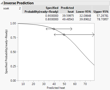

6. Click OK.
Figure 11.8 Inverse Prediction Report
When soak is 2, the predicted value of heat for which there is a 90% chance of an ingot being ready to roll is 39.60 with a 95% confidence interval from 32.09 to 57.29. When soak is 2, the predicted value for heat for which there is an 80% chance of an ingot being ready to roll is 49.49 with a 95% confidence interval from 39.90 to 78.71.
