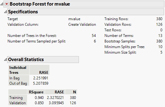

Create the Bootstrap Forest Model and Save the Prediction Formula to a Column
1. Select Analyze > Predictive Modeling > Bootstrap Forest.
2. Select mvalue and click Y, Response.
3. Select crim through lstat and click X, Factor.
4. Select Create Validation and click Validation.
5. Click OK.
6. Select the Early Stopping check box.
7. Select the Multiple Fits over number of terms check box.
8. Enter 617 in the box next to Random Seed.
9. Click OK.
Figure 10.3 Bootstrap Forest Model
10. To save the prediction formula to a column, click the Bootstrap Forest red triangle and select Save Columns > Save Prediction Formula.

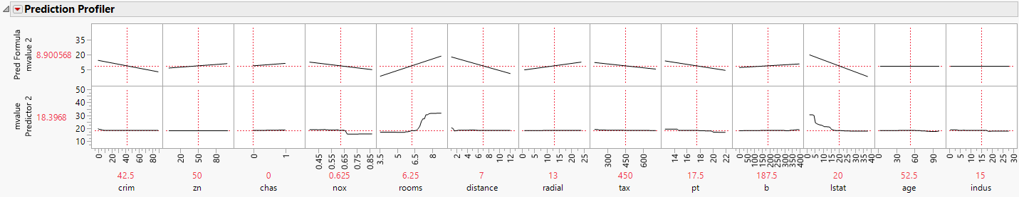

5. Click the Model Comparison red triangle and select Profiler.
Figure 10.5 Prediction Profiler for All Models
The prediction profiler enables you to compare the impact of each factor in the different models. The profiler is especially interesting when comparing different types of models such as here where you have a regression model and a partition model.
