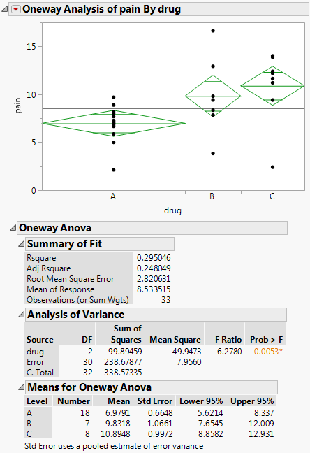

Figure 6.2 Example of Oneway Analysis

6. Click the red triangle next to Oneway Analysis of pain By drug and select Means/Anova.

Figure 6.3 Example of the Means/Anova Option
Note the following observations:
• Mean diamonds representing confidence intervals appear.
– The line near the center of each diamond represents the group mean. At a glance, you can see that the mean for each drug looks significantly different.
– The vertical span of each diamond represents the 95% confidence interval for the mean of each group.
See Mean Diamonds and X-Axis Proportional.
• The Summary of Fit table provides overall summary information about the analysis.
• The Analysis of Variance report shows the standard ANOVA information. You notice that the Prob > F (the p-value) is 0.0053, which supports your visual conclusion that there are significant differences between the drugs.
• The Means for Oneway Anova report shows the mean, sample size, and standard error for each level of the categorical factor.
