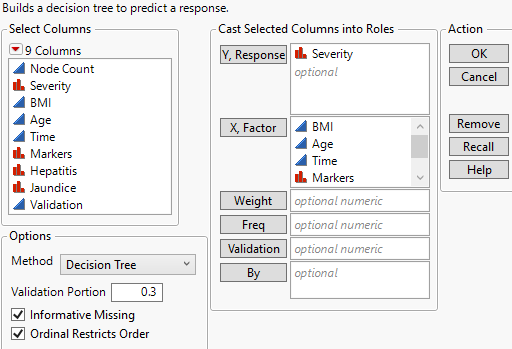

5. Select a validation procedure based on your JMP installation:
– For JMP Pro, select Validation and click Validation.
– For JMP, enter 0.3 as the Validation Proportion.
Note: Results using the validation proportion can differ from those shown here, due to the random selection of validation rows.
Figure 4.25 Completed Launch Window with Validation Portion = 0.3
6. Click OK.
