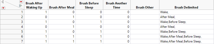

2. Scroll to the right until you see the Brush Delimited column.
Figure 3.19 Consumer Preferences Data Table
Note that the Brush Delimited column contains the responses to a multiple response question. Each response is separated by a comma. The four columns preceding Brush Delimited contain the same information in a different data format. Each column (Brush after Waking Up, Brush After Meal, Brush Before Sleep, and Brush Another Time) contains one response. If the response was selected the column value is a 1, and otherwise it is 0.
