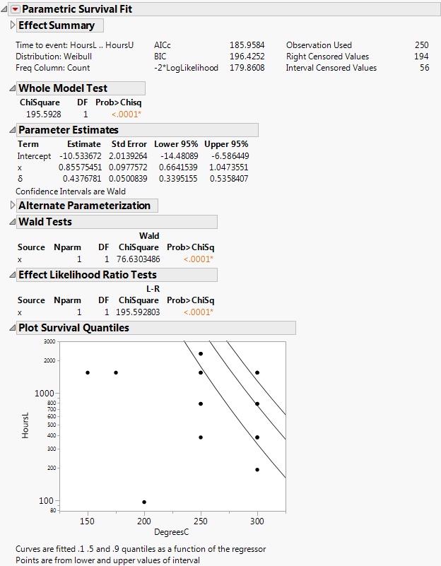

The ICdevice02.jmp data shows failures that were found to have happened between inspection intervals. The model uses two y-variables, containing the upper and lower bounds on the failure times. Right-censored times are shown with missing upper bounds.

Figure 14.12 ICDevice OutputĀ
The resulting regression shows a plot of time by degrees.
