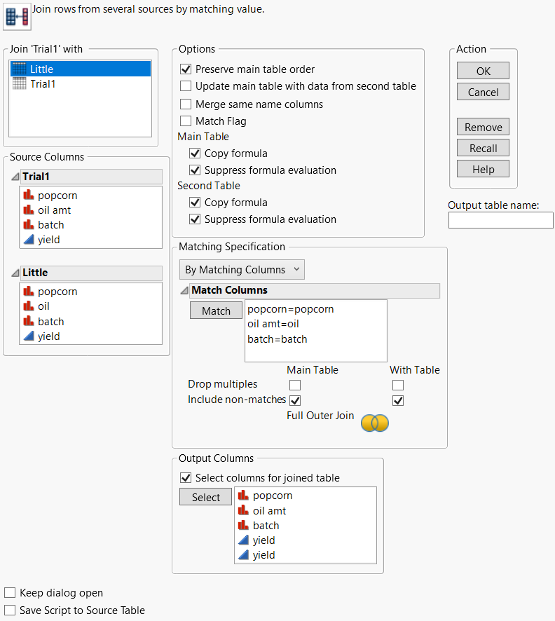

4. In the Join ‘Trial1’ With box, select Little.
5. From the Matching Specification menu, select By Matching Columns if it’s not already selected.
6. In the Source Columns boxes, select popcorn in both boxes, and then click Match.
7. In the same way, match batch to batch and oil amt to oil in both boxes.
Your matching columns do not have to have the same name.
8. Select Include non-matches for both tables.
Since one experiment is partial, you want to include all rows, including any with missing data.
9. To avoid duplicate columns, select the Select columns for joined table option.
10. From Trial1, select all four columns and click Select.
11. From Little, select only yield and click Select.
Figure 3.27 Completed Join Window

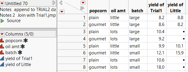

12. Click OK.
Figure 3.28 Joined Table
