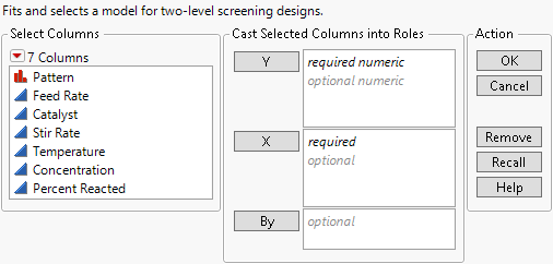

Launch the Fit Two Level Screening platform by selecting DOE > Classical > Two Level Screening> Fit Two Level Screening.
Figure 10.4 Launch Window for the Fit Two Level Screening Platform
Y
The columns to be analyzed. These must have a Numeric data type.
X
Continuous or discrete two-level orthogonal factors.
By
A column whose level define separate analyses. For each level of the specified column, the corresponding rows are analyzed. The results appear in separate reports. If more than one By variable is assigned, a separate analysis is produced for each possible combination of the levels of the By variables.
Note: If you created your design in the Screening Design Platform from a list of fractional factorial designs, the design table contains a script called Screening. Run this script to run the analysis directly.
