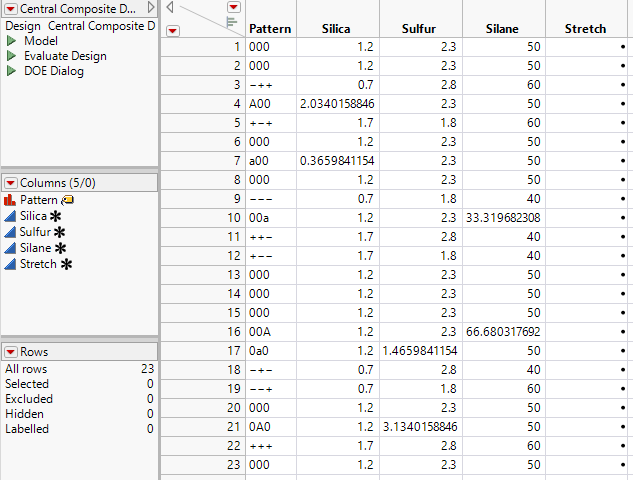

Figure 11.17 Orthogonal Central Composite Design for Bounce Factors and Response
The Design note in the Table panel at the upper left gives the design type that generated the table (Central Composite Design). This information can be helpful if you are comparing multiple designs.

Design Table Scripts
The design table includes the following scripts:
Model
Runs the Analyze > Fit Model platform.
Evaluate Design
Runs the DOE > Design Diagnostics > Evaluate Design platform.
DOE Dialog
Re-creates the Response Surface Design window that you used to generate the design table. The script also contains the random seed used to generate your design.
