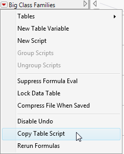

1. In the data table, click the red triangle next to the data table name and select Copy Table Script.
Figure 10.13 Copying a Table Script
