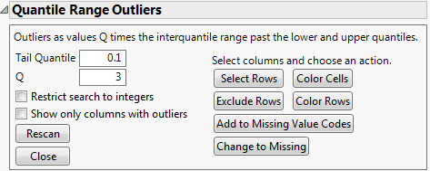

The Quantile Range Outliers panel enables you to specify how outliers are to be calculated and how you want to manage them.
Figure 20.6 Quantile Range Outliers Window
An outlier is considered any value more than Q times the interquantile range from the lower and upper quantiles. You can adjust the value of Q and the size of the interquantile range.
Tail Quantile
The probability for the lower quantile that is used to calculate the interquantile range. The probability of the upper quantile is considered 1 - Tail Quantile. For example, a Tail Quantile value of 0.1 means that the interquantile range is between the 0.1 and 0.9 quantiles of the data. The default value is 0.1.
Q
The multiplier that helps determine values as outliers. Outliers are considered Q times the interquantile range past the Tail Quantile and 1 - Tail Quantile values. Large values of Q provide a more conservative set of outliers than small values. The default is 3.
Restrict search to integers
Restricts outlier values to only integer values. This setting limits the search for outliers in order to find industry-specific missing value codes and error codes.
Show only columns with outliers
Limits the list of columns in the report to those that contain outliers.
