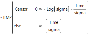

In the exponential loss function shown here, sigma represents the mean of the exponential distribution and Time is the age at failure.
Exponential Loss Function
A characteristic of the exponential distribution is that the instantaneous failure rate remains constant over time. This means that the chance of failure for any subject during a given length of time is the same regardless of how long a subject has been in the study.

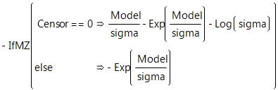

The Weibull density function often provides a good model for the lifetime distributions. You can use the Survival platform for an initial investigation of data to determine whether the Weibull loss function is appropriate for your data.
Weibull Loss Function
There are examples of one-parameter, two-parameter, and extreme-value functions in the Loss Function Templates folder.

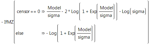

If Y is distributed as the logistic distribution, Exp(Y) is distributed as the loglogistic distribution.
Loglogistic Loss Function
