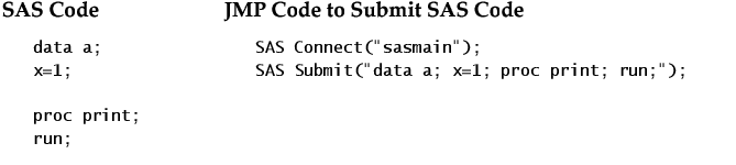

Figure 3.62 SAS Code Submission Example

To run SAS code using a JSL script
Write and run a JSL script that uses either the SAS Submit or SAS Submit File JSL functions. For more information about writing JSL scripts that submit SAS code, see Working with SAS in the Scripting Guide.
