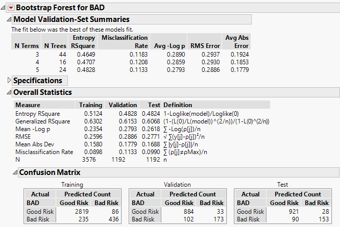

Figure 5.10 Bootstrap Forest Report for a Categorical Response

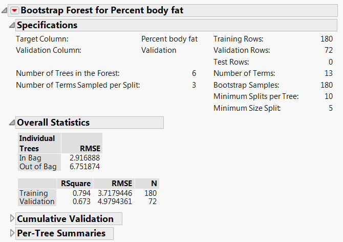

Figure 5.11 Bootstrap Forest Report for a Continuous Response
The following reports are provided, depending on whether the response is categorical or continuous:
• Model Validation-Set Summaries
• Specifications
• Overall Statistics
• Cumulative Validation
• Per-Tree Summaries
