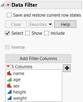

Figure 9.7 Initial Data Filter Window
2. Select the columns that you want to use as filters, and then click Add .
