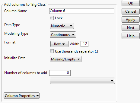

Figure 5.2 The Column Info Window
The Column Info window contains the following information:
Column Name
Type or edit the name of the column.
Lock
Lock the column so that none of its values can be edited. After you lock a column, the lock icon () appears next to the column name in the data table’s Columns panel. If you add a formula to a column, the column automatically locks.
Data Type
Select or change the data type of a column, which determines the following:
– How the column’s values are formatted in the data grid
– How the column’s values are saved internally
– Whether the column’s values can be used in calculations
See About Modeling Types.

Format
(Numeric data types only) Select or change the display format of a numeric column. See Numeric Formats.
Initialize Data
(Appears only during new column creation) Specify the type of initial data values that you want to appear in the column. See Initialize Data.
Column Properties
(Contains a list of different properties) Assign properties to columns. See Column Properties.
Tip: Click the Next button to continue adding columns.
