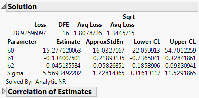

7. Click Confidence Limits.
Figure 14.13 Solution Report
