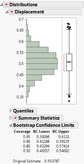

Bootstrapping is a resampling method for approximating the sampling distribution of a statistic. You can use bootstrapping to estimate the distribution of a statistic and its properties, such as its mean, bias, standard error, and confidence intervals. Bootstrapping is especially useful in the following situations:
• The theoretical distribution of the statistic is complicated or unknown.
• Inference using parametric methods is not possible because of violations of assumptions.
Note: Bootstrap is available only from a right-click in a report. It is not a platform command.
Figure 11.1 Bootstrapping Results for a Slope Parameter
