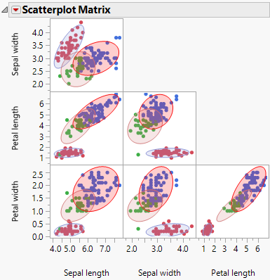

9. Perform the Scatterplot Matrix analysis. Follow the instructions in the section Example Using a Grouping Variable, but use Cluster as the grouping variable.
Figure 6.9 Example of a Scatterplot Matrix Using a Cluster Variable
