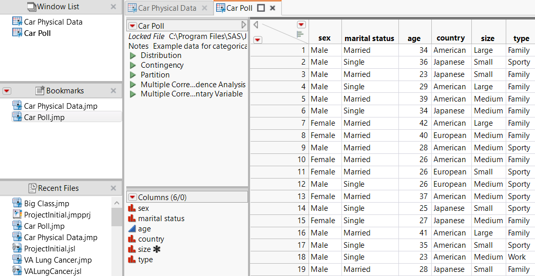

Figure 10.15 Initial Project

1. In the Window List, right-click one of the file names and select Bookmark All.
You can also drag the files from the Window List to the Bookmarks pane.
2. To create a group for the data tables, click the red triangle and select New Group. The group organizes the files but does not move them on your computer.
3. Enter Data and click OK.
4. In the Bookmarks pane, select the Car data tables and drag them into the Data group.

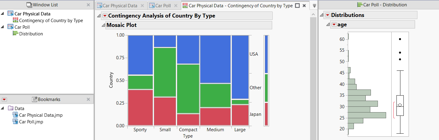

Figure 10.16 Bookmarked Files

Figure 10.17 Tabbed Reports

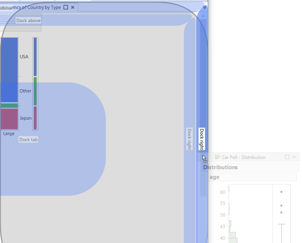

3. Drag the Distribution report tab to the right until the Dock right zone appears on the far right.
Figure 10.18 Dragging a Report

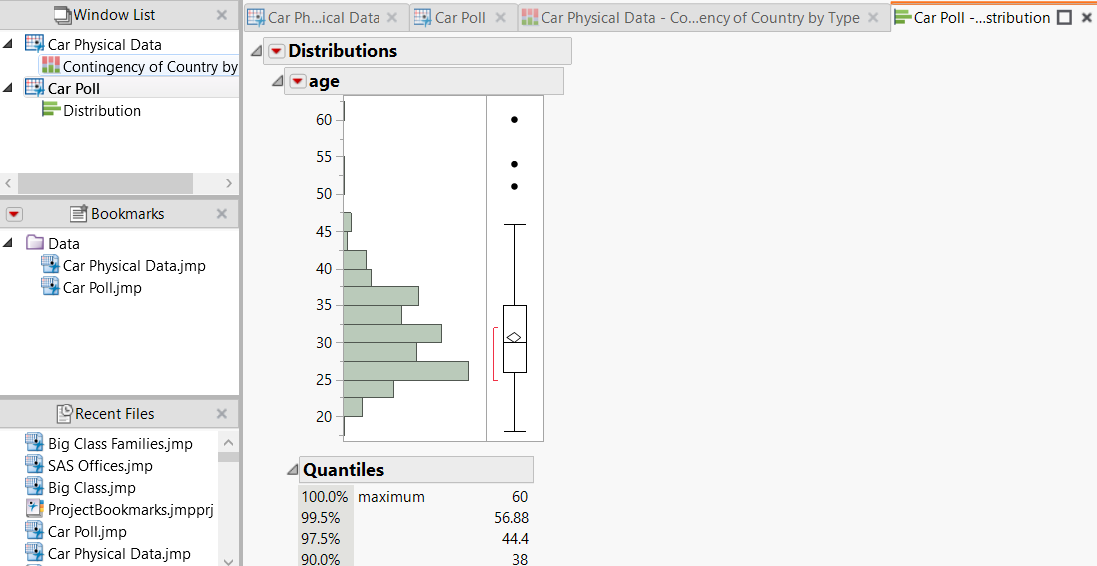

4. Drop the report into the Dock right zone.
The tab appears in a new pane.
Figure 10.19 Report in New Pane

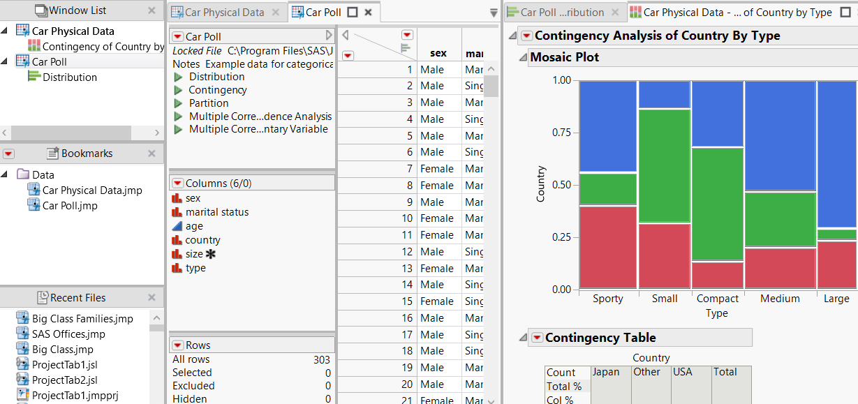

5. Drag the Contingency tab to the middle of the Distribution report.
6. When the Dock tab zone appears, drop the report.
Figure 10.20 Docked Report Tabs
