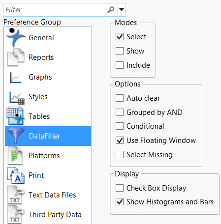

Data Filter preferences customize settings for data filters.
Figure 13.6 Data Filter Preferences
Table 13.6 Preferences on the Data Filter Page
Preference
Description
Modes
Specifies the filtering mode.
Select
Shows the selected rows in the data table in a highlighted state.
Show
Shows the unselected rows with the Hide icon.
Include
Shows the unselected rows with the Exclude icon.
Options
Specifies options for the data filter.
Auto clear
If you have more than one nominal or ordinal column selected in the Data Filter, this option clears any other selections before making a new selection.
Grouped by AND
Enables you to control the AND and OR behavior of multiple groups of column filters.
Conditional
Limits the categories displayed for the selected filter column.
Use Floating Window
Keeps the Data Filter window on top of its associated data table. This option is on by default.
Select Missing
Highlights missing values in the data table.
Display
Specifies display options for categorical columns.
Check Box Display
Shows a check box next to each level.
Show Histograms and Bars
Shows the histogram and bars in the data filter.
