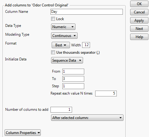

4. Next to Column Name, type Day.
5. From the Initialize Data list, select Sequence Data.
6. Enter the following:
– 1 for From
– 3 for To
– 1 for Step
– 5 for Repeat each value N times
7. Next to Number of columns to add, type 1.
Figure A.11 Completed New Columns Window
8. Click OK.
