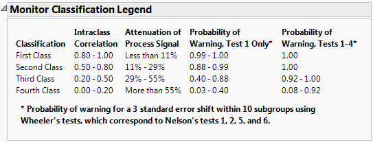

Classes of Process Monitors
In order to understand the System and Classification parameters, you must first understand the Monitor Classification Legend.
Figure 4.6 Monitor Classification Legend
This legend describes the following classifications: First, Second, Third, and Fourth Class. Each classification indicates the following:
• the corresponding Intraclass Correlation values
• the amount of process signal attenuation (decrease)
• the chance of detecting a 3 standard error shift within 10 subgroups, using Wheeler’s test one or all four tests
Wheeler (2006) identifies four detection tests known as the Western Electric Zone Tests. Within the Shift Detection Profiler, there are eight tests that you can select from. The tests that correspond to the Wheeler tests are the first, second, fifth, and sixth tests.
