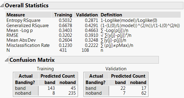

8. Click OK.
Figure 6.2 Overall Statistics for Nominal ResponseĀ
Because the response, Banding?, is categorical, the Boosted Tree analysis provides a Misclassification Rate under Measure and a Confusion Matrix report. The Misclassification Rate for the validation set is 0.2222, or about 22%.

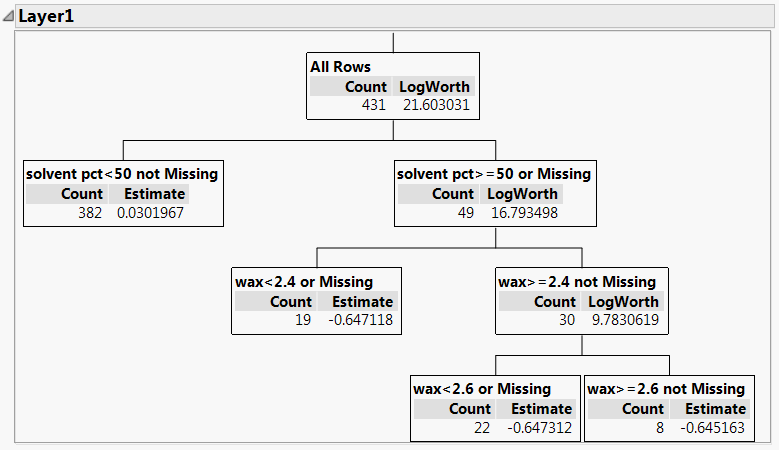

9. Click the red triangle next to Boosted Tree for Banding? and select Show Trees > Show names categories estimates.
A Tree Views report appears, with outlines for the layers. You can examine the layers to see the trees that are fit and the predicted values.
Figure 6.3 Layer 1 of the Boosted TreeĀ
