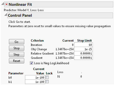

The Nonlinear Fit Control Panel appears.
Figure 14.12 Nonlinear Fit Control Panel
