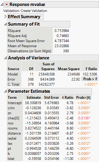

Figure 10.2 Fit Model Report
10. To save the prediction formula to a column, click the Response red triangle and select Save Columns > Prediction Formula.

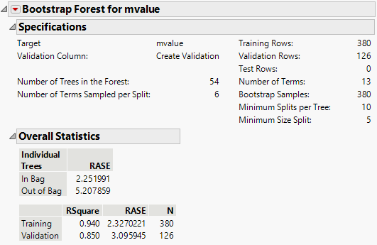

Figure 10.3 Bootstrap Forest Model
10. To save the prediction formula to a column, click the Bootstrap Forest red triangle and select Save Columns > Save Prediction Formula.

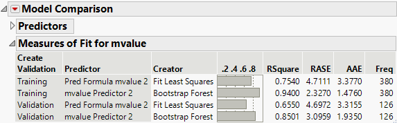

Figure 10.4 Model Comparison Report
The rows in the training set were used to build the models, so the RSquare statistics for Create Validation = Training might be artificially inflated. In this case, the statistics are not representative of the models’ future predictive ability. This is especially true for the bootstrap forest model.
Compare the models using the statistics for Create Validation = Validation. In this case, the bootstrap forest model predicts better than the regression model.

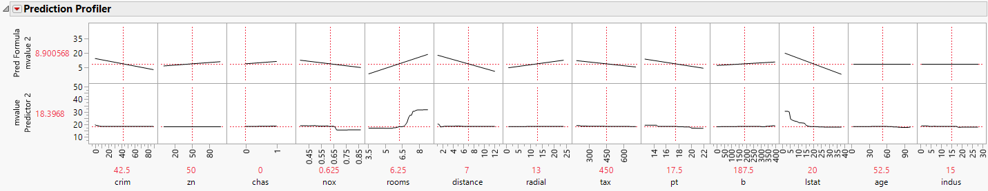

5. Click the Model Comparison red triangle and select Profiler.
Figure 10.5 Prediction Profiler for All Models
The prediction profiler enables you to compare the impact of each factor in the different models. The profiler is especially interesting when comparing different types of models such as here where you have a regression model and a partition model.
