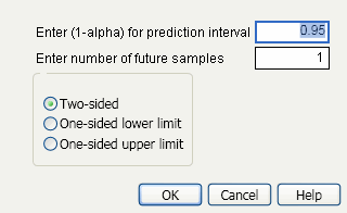

Figure 3.17 The Prediction Intervals Window
6. In the Prediction Intervals window, type 10 next to Enter number of future samples.
7. Click OK.

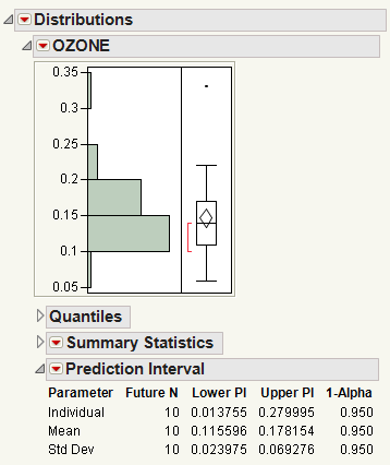

Figure 3.18 Example of a Prediction Interval Report
In this example, you can be 95% confident about the following:
• Each of the next 10 observations will be between 0.013755 and 0.279995.
• The mean of the next 10 observations will be between 0.115596 and 0.178154.
• The standard deviation of the next 10 observations will be between 0.023975 and 0.069276.
