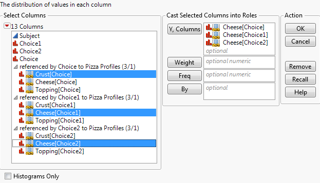

5. In Pizza Responses.jmp, select Analyze > Distribution.
6. Scroll down to select the three Cheese columns in the referenced column groups, click Y, Columns, and click OK.
Figure 6.37 Distribution Launch Window

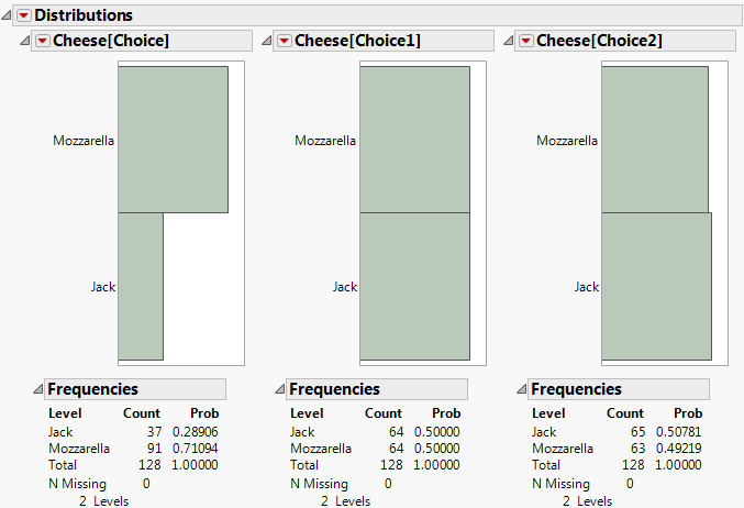

More respondents chose Mozzarella in the Choice column. In Choice1 and Choice2, the proportion of Mozzarella to Jack is nearly even.
Figure 6.38 Distribution of Pizza Responses
