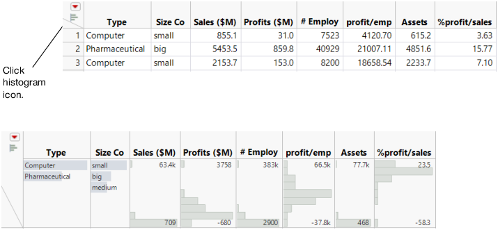

Instant Histograms
You can view a histogram instantly by clicking the histogram icon in the column header. Histograms appear below the column header.
Figure 4.3 Instant Histograms

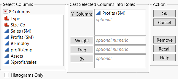

Create the Histogram
1. Select Help > Sample Data Library and open Companies.jmp.
2. Select Analyze > Distribution.
3. Select Profits ($M) and click Y, Columns.
Figure 4.4 Distribution Window for Profits ($M)
4. Click OK.
