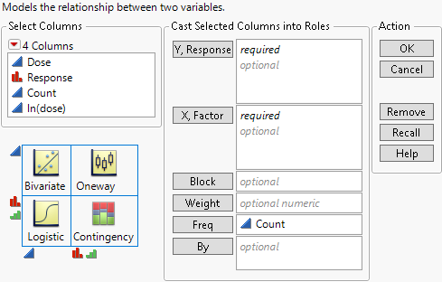

Launch the Fit Y by X platform by selecting Analyze > Fit Y by X.
Figure 4.2 The Fit Y by X Launch Window
Bivariate, Oneway, Logistic, Contingency
This grid shows which analysis results from the different combinations of data types. Once you have assigned your columns, the applicable platform appears as a label above the grid.
Block
(Optional. Applicable only for Oneway and Contingency.):
– For the Oneway platform, specifying a Block variable identifies a second factor, which forms a two-way analysis without interaction. The data should be balanced and have equal counts in each block by group cell. If you specify a Block variable, the data should be balanced and have equal counts in each block by group cell. In the plot, the values of the Y variable are centered by the Block variable.
– For the Contingency platform, specifying a Block variable identifies a second factor and performs a Cochran-Mantel-Haenszel test.
